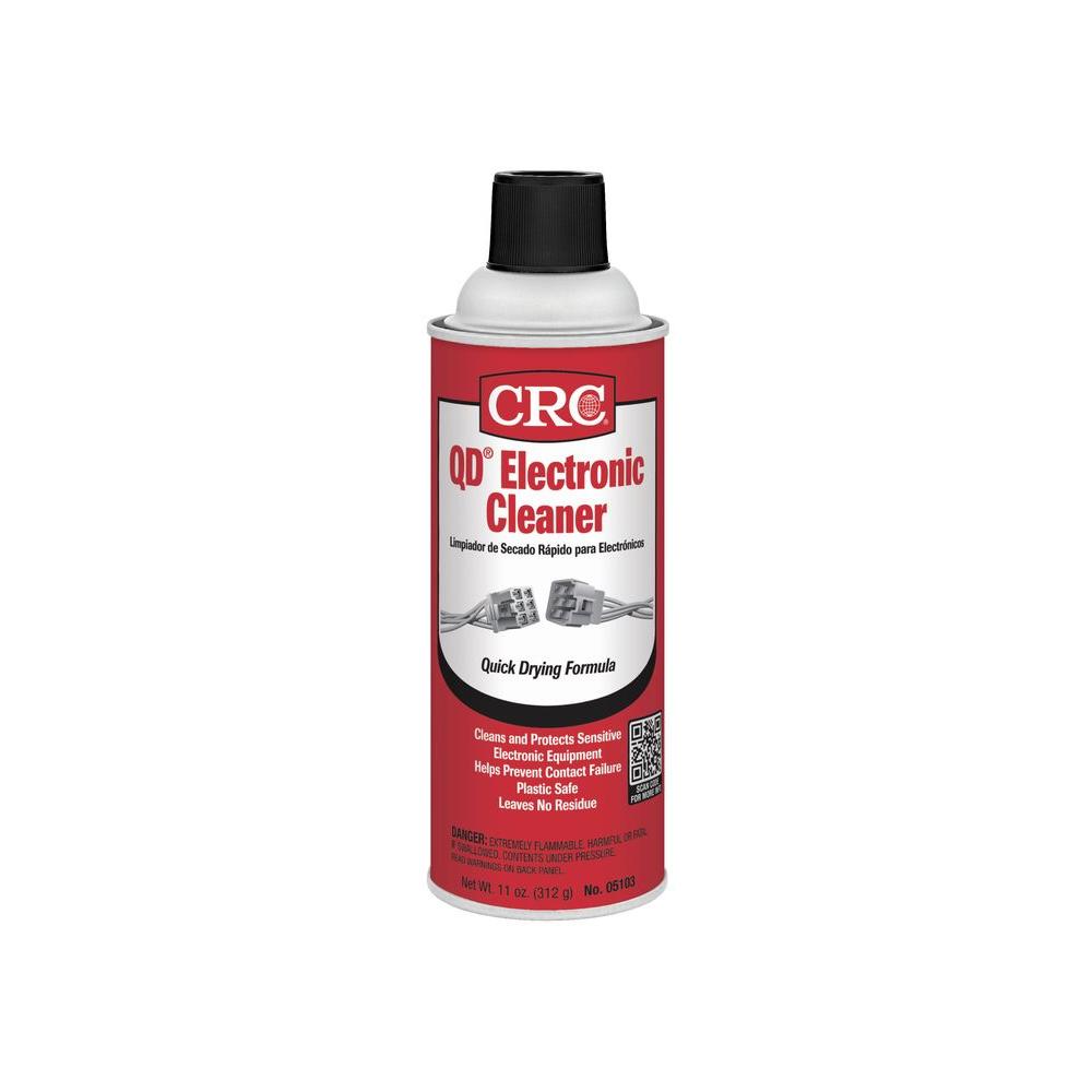

Rinse all the parts down with CRC contact cleaner:
