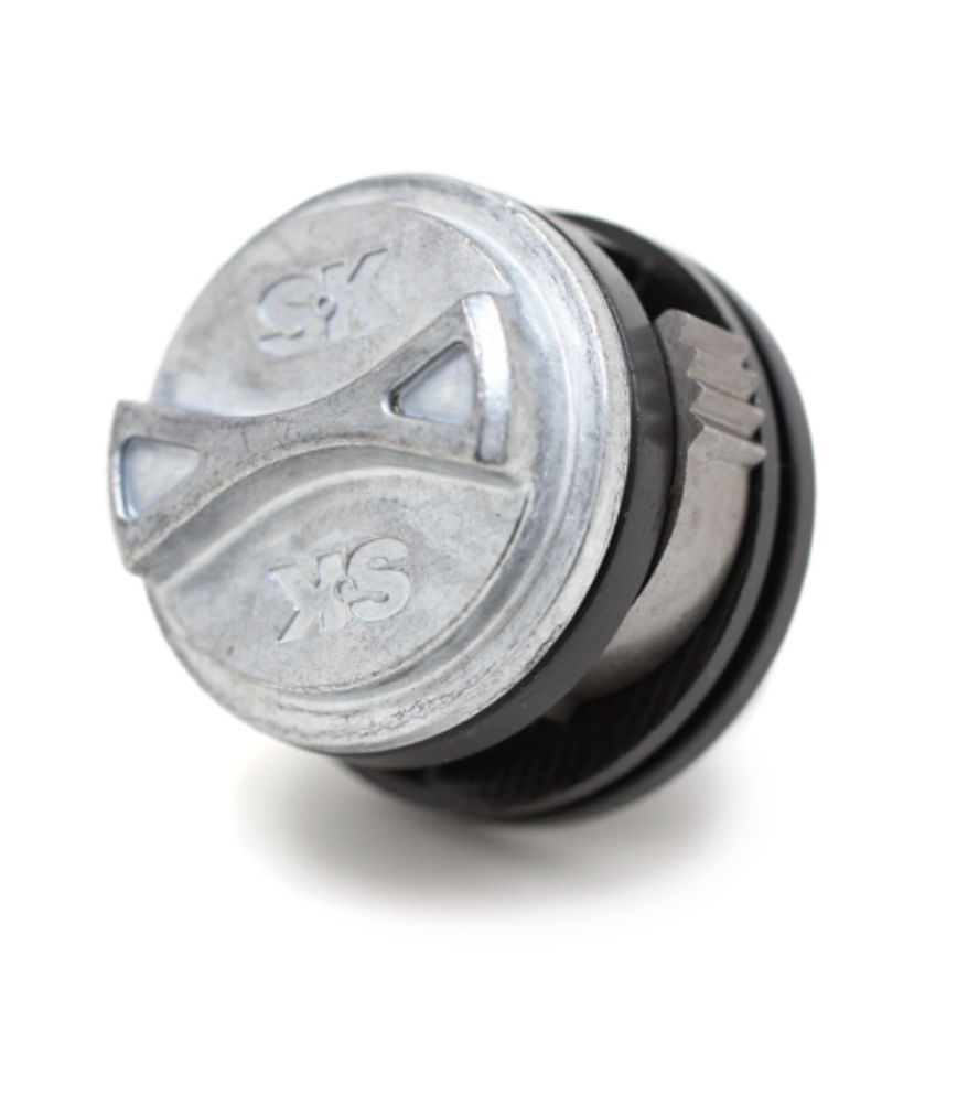

As long as the teeth in the head are OK I'd buy and install a DT80 rebuild kit. Makes the old workhorse a finer tooth ratchet, pops right in with no modifications, and will restore proper function. For $25 or so it's worth it.
Epstein has them for $22.
