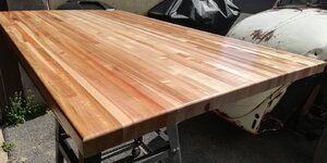

vwpieces
Apr 28, 2020
5,925
Hills, PA
recently saw bowling alley for $25/ft around here.
Couple years ago I found some tractor trailer flooring for sale. I bought 12X 10ft lengths for $20ea.
It was all new, unused but seconds I assume. Still good hardwood butcher block type for cheap.
Something to look into if you might have a trailer builder reasonably local.
This was going to be a portable table/workbench for the car shop. But it turned out too nice for that. Its now a work table for electronics and soldering in the basement.
KEH
Jan 31, 2010
5,142
VWpieces bench is gorgeous! I predict an increase in the price of surplus trailer flooring as woodworkers jump on that.
