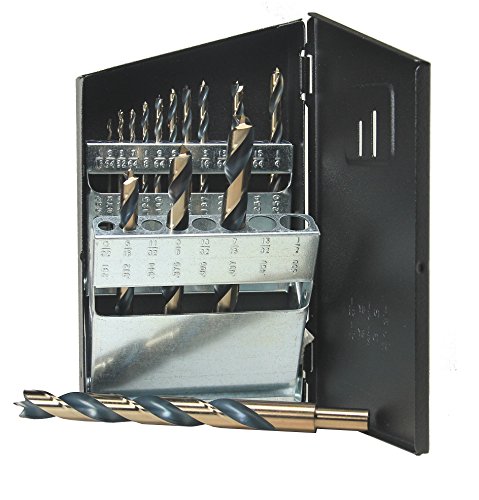

You want good than this is what you want.
You want cheap than any Chinese set will work for you.
Yep. My dad, before he passed on, bought me a full set of several types of Norseman bit sets. I love them. Rarely need to resharpen any. Neighbor wants to borrow some. I handed him the old generic bits I have in a drawer. Never loan out the good stuff. (Father in law is the sole exception)
