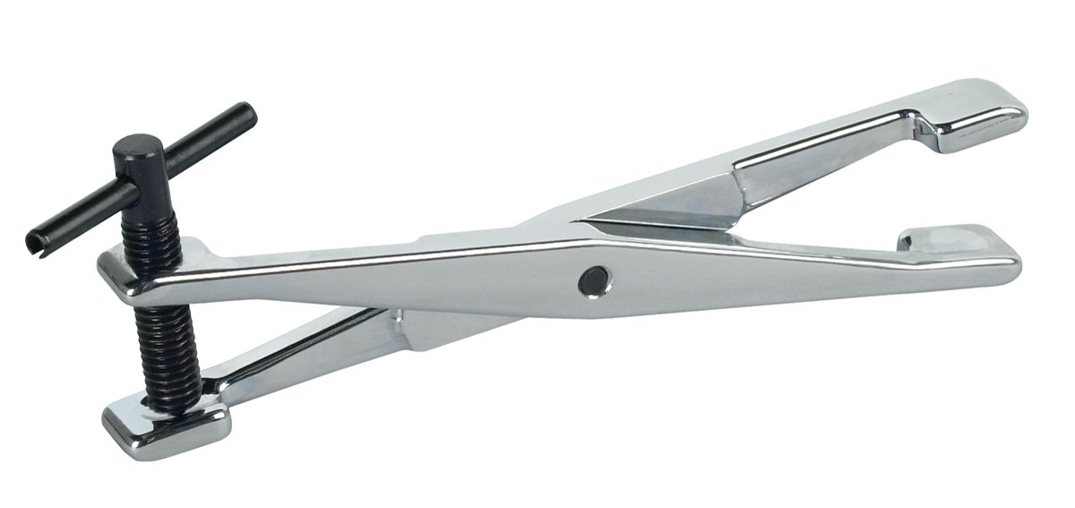

So, what is the tool of choice for multi piston calipers? With and without removing the caliper?
this style would be a great 4 piston 300zx, Brembo on new 300 chrysler/Camaro, Tundra/tacoma brakes.
This Lisle is also very nice http://www.lislecorp.com/divisions/products/?product=570&division=1&category=1
I can't find the picture of this scissor style motorcycle/car style that is a true universal for single, dual, or quad piston setups. the only setup it doesn't work on is the screw in

Well it seems like a tapped plate with beefy bolt will make the best tool. I'm set on making something decent.
Aetsh
Jan 12, 2012
98
Youngstown,Ohio
Yes, I have that tool. It works perfect every time! It will do duals as well as singles, just gotta be a bit creative doing duals..
Cheap too, $20 or so off the snappy truck

The Blue Point BTCP500 brake spreader tool looks good but it is $65.20. Does it work better and faster than the Lisle 24300 Speedy Brake Pad Spreader?
But you can get the same exact tool with a different color handle labeled the Kastar 279 for ~$38 from Tool Discounters.
I think the Kastar\Bluepoint design looks better than the Lisle but I'd love to hear from someone who's used both and can compare them?

I have both of these and they work great.
Lisle 25750 Dual Piston Brake Caliper Compressor
and
Fast as lightening.
But they take up a lot of space. It seems this Kastar would help gain valuable space in an already over stuffed box. ***** that i got $100 sunk into the Lisle's.

I just picked up the Matco version of the Kastar design. I chose it over the trigger types because of its mechanical advantage having the spreading pressure right in the center.
The others tend to flex, more so on harder calipers. Also, the Kastar plates are thick, they wont be flexing at all.

I'll have to get some dimensions when I get back home. It is advertised as working on both dual and quad piston, floating and fixed. I think anything over quad piston and the plates wouldn't be big enough.
rmsg0040
Feb 15, 2012
2,636
Toronto
^^ when I used it on my dad's chevy venture they pushed the pistons all the way in, but when I went to removed the tool, the plates fell out from being over extended. Thought it was a fluke but happened on the other side also.

I have this tool and like it. Save an old pad. Open/extend the pads most of the way. Then, put in the old pad as a shim and extend fully as needed if you are having a problem with yours.

Is there enough room on small calipers to swing the Blue Point/Kastar tool handle?
Does the Blue Point/Kastar extend out far enough on larger calipers?
wjamyers
May 7, 2013
361
Falls Church, VA, USA
I have the Kastar branded one but the BluePoint is the same think just different name and about $23 more. Best one I have ever used.
http://www.tooltopia.com/kastar-hand-tools-279.aspx
http://buy1.snapon.com/catalog/item...roup_ID=675710&store=snapon-store&dir=catalog
Can you use this while the caliper is still mounted? to swap out pads on a set of brembos, for example?
I just ordered them because it looks like it should be able to do that even though the How To vid online shows the entire thing being placed inside a dismounted caliper.
Please let me know.

I've used that one for my brembos. Still have to unbolt the caliper or the rotor is in the way.
Sent from my SCH-I535 using Tapatalk 2
well that *****. part of the point of brembo-style brakes is to make switching pads easy by not requiring caliper removal. now I've gone and ordered a tool (from EBAY no less, no cancellation) I will not even be able to use the way I intended.
Are you certain you couldn't slip the edges in there around the rotor, perhaps push on the old pads before you remove them?
because there's no way in hell i'm going to remove my calipers when it's not necessary to do so.

This may be silly because I haven't worked on brembo brakes but when I change pads I service the rotors also. Which require taking the caliper off. Also, if the brembos are made to not have to take the caliper off then why would you need any tools to push the piston back in? I would think if they are made to not have to take the caliper off to change the pads that there would be a way to retract the piston without taking the caliper off?
wjamyers
May 7, 2013
361
I don't think you would service rotors while switching to and from race pads for a track day or replacing fried pads during one.
race-style calipers make these jobs easier to perform and there are a couple of tools I have confirmed from reviews that will do the job with calipers-mounted, the girodisk at $225.00 and this one:
Also, note this:
Feature: Simple pad change with one bolt
Are you tired of taking off your calipers every time you go to the track? Sick of the little spring clips flying across the garage every time you pull out the pads? Frustrated with trying to find a good place to rest your caliper while it's still attached to the brake line?
Benefits:
With the CP8350 you only have to remove one simple hex bolt on top of the caliper. That's it. Loosen, remove the old pads, and drop in the new ones. It will take you substantially longer to raise the car and remove the wheels than it will to change your pads. Swapping pads will no longer be a chore to dread on the Friday night before every event.
These top-of-the-line $2600.00 race calipers don't provide any way to spread the pistons.
I guess I screwed up and shoulda tried that cheapie from Amazon first. Maybe I'll get lucky and figure out a way to use the one I ordered.
I'll report back what I find.
