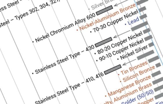

Quick question I have a plumbing project coming up and have a surplus of 3/4" brass and stainless steel fittings. Can these be interchanged and attached to each other. My thought is being dissimilar metals will there be any reaction?

Thanks guys, I am using them to install a descaling filter for my new yet to be installed water heater. The instructions don't like copper in the mix, everything from my well pump to the pvc leading into the house is already brass.

From the link:
“The Reason Some Stainless Steels and Brasses Do not Work Together
The metals should have no more than a .15V to .25V on the anodic index or metals that are extremely close together as listed on the index. In the case of stainless steel (410) and brass, they are seven metals apart, which means they would be likely to corrode if connected directly. When it comes to stainless steel (301, 304 and 310) and brass, they are only two metals apart, which means they can be safely connected together with minimal risk of galvanic corrosion.”

I concur, brass and stainless aren’t too far away from each other on the galvanic chart. That should be ok. Remember stainless is steel with chromium and nickel. Brass is copper and zinc. Zinc is at the bottom of the chart, but copper is next to stainless.
