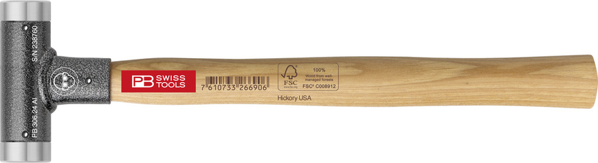

My only brass hammer is in bad shape and I really like the Wiha and Gedore engineers / dead blows. I figured I would get a brass version but none to be found. In fact it seems the brass hammer is not to be found in the whole country (as represented by KC Tool) https://www.kctoolco.com/hammers/
Am I missing something? Has Germany evolved to nylon, poly faced hammers, of which there are a great many?

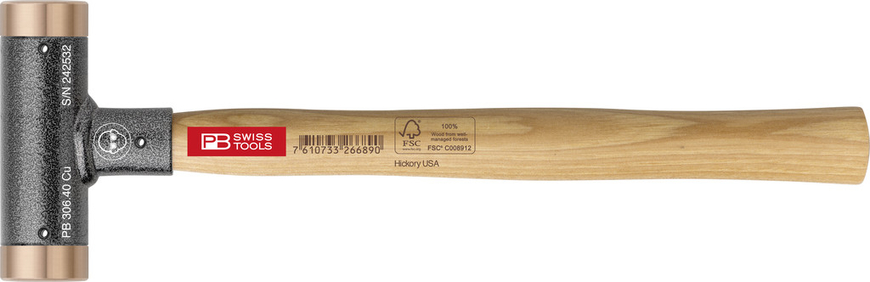

Picard is German and makes Copper hammers (e.g. https://www.kctoolco.com/picard-17oz-copper-hammer-mining-sledge-pattern/). Hazet seems to rebrand the Picard hammers. Copper should be able to do most of what a brass hammer can, although it'll likely get a bit more mangled if you really beat on things.

Thorex (made in England) have over 20 pages of soft faced hammers and mallets on their website, including brass ones!
I think they are imported to the U.S. by Vaughan

Copper is softer and deforms more, and brass is harder. Sometimes one is "more righter" for whatever you're doing. So as ever, the proper GJ answer to "which tool" is "all the tools".
Vaguely related anecdote: I inherited a huge ugly copper hammer from my Dad, about five pounds. I found it just sort of lying under a bunch of **** in the driveway, covered in layers of greasy filth that actually preserved it pretty well, and immediately claimed it.
It's become an invaluable and extremely handy thing-I-didn't-know-I-needed-until-I-had-one, perfect for installing bearing races and other "thumping steel without damage" tasks.

It's the hardness and weight of the hammer vs. what you're hitting and how hard you want to hit it.
From hardest to softest:
Brass
Copper
Lead
Plastic, wood
Rubber
Rawhide
I use my copper mjolnir most often for driving bearing races on motorcycles. The bearing races are hardened steel, and copper is dense enough to deliver a mighty thwack, but too soft to damage the steel. Copper is malleable enough that it holds together pretty well and can do its job with some marring, but not usually much chipping.
Brass would also work pretty well, but it's a harder than copper and it can be a little more brittle. Bearing races have sort of sharp edges, so a brass hammer might mar a little less, but could crack.
Lead would also work for this, but it's much softer and would damage the hammer a lot morem with chips flying everywhere. Plus, you know, lead, brain damage, etc.
A plastic or wood mallet wouldn't damage the bearing races, but would be too light to do much good. Rubber is a little heavier, but still not heavy enough and will bounce off; it doesn't deliver as much energy into the target.
As with anything else, you have to pick the right hammer material and weight for the job at hand.
