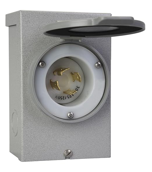

Hello! I would like to start with saying that I plan to have this done by an electrician. At the same time I would like understand different alternatives I have.
I would like to add the following:
-Interlock for generator (Need 240V for the well pump)
-Dedicated circuit (240V?) in the garage for a welder
-Future AC in the house
-Other future upgrades (compressor, secondary heater, etc)
Current panel (Murray LC124DS) with small sub-panel (Murray LW002GR) below it.
Sub panel
I'm not sure if it helps determine a path going forward but a shot of the inside
As you can see they are both full. I can re-purpose 1 breaker as there is no longer a pool in the backyard, but that doesn't really help.
Incoming wire appears to be 2ga Alum. Which from my research is 100A current limit. Will need to work with the power company to upgrade?
My initial thought was to install a new 200A panel and make the current 100A panel a sub panel. This would allow for an interlock on the 200A, reduce the amount of re-wiring, and allow for future expansion. I would think the current sub panel breakers would be moved into the new panel. The alternative would be remove this panel and place a 200A panel in its place.
Thoughts from those who are more experienced on how to complete the outlined goals?

When you mention an interlock for a generator hookup, I assume you mean you want to hook up your portable 240 VAC generator using a cord? There would be a box outside under the meter for the generator hookup, perhaps like this:
...and an interlock kit in the main panel that forces you to turn off your main before you can close the generator breaker? You aren't looking for a whole house generator with a transfer switch that is permanently mounted, right?

Yes the plan would be a main interlock with an outdoor receptical and cord for a portable generator.
Good deal. That should be an easy task provided you get the generator interlock kit for the panel.

-generator outlet on the outside of the house
