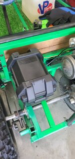

I painted my son's go-kart with that same paint. Had to use a primer under it and then 2-3 very wet coats, so wet that we had runs in some places. It's not the best paint job, but it's a go-kart so it's no big deal. 20220528_163528.jpg20220515_195918.jpg
