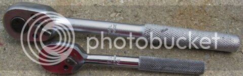

Pics below show a 3/8 drive socket , a 1/2 inch drive socket compared with a modern Snap On (great minds think alike, no wonder so many Brit's go straight for Snap On now Britool are gone), some 1/2 inch drive accessories, and a comprehensive 1/2 inch drive set. The latter belonged to my Dad, and lived under my bed as a kid as he wouldn't risk leaving it in the garage!

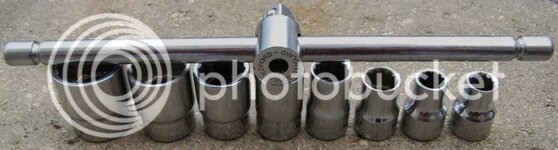

Below are pictures of some Bedford Sockets and handles, a Bedford 1/2 inch drive set (note distinctive orange box) and a Bedford Wrench compared to a Britool. Don't know how much Bedford made it to the USA, but worth acquiring if found at a reasonable price!

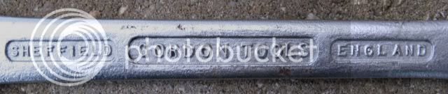

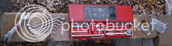

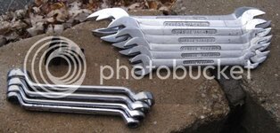

Here's most of my collection...
Some Gordon:
Bedford:
And a set of small BA DBE spanners from after the Spear & Jackson acquisition...
Britool:
(the socket set in the middle bottom in the photo above are actually the Bedfords, as is the sliding T-handle)
The little socket set is actually 9/32"-drive...
And some Record vises, hammers and a small anvil...

That's beautiful stuff you've got there ibgradwell! I always liked the Gordon ratchet's - nice and durable!
Likewise the chrome on the Gordon DBEs.
I was very lucky to find that Gordon set nearby for $50. ;)
As you might imagine, these old British sets are not very common here in the "colonies"...

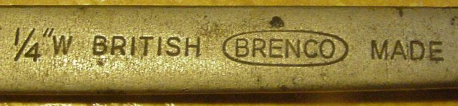

I have seen a few Brenco ring spanners before. I don't think they're MoD stock? I think the ebay seller is spinning a yarn. Bren Guns were made by the Royal Small Arms Factory, Enfield and were based on a Czech design. Bren came from Brno in Czechoslovakia and Enfield- BR/EN - Bren.
I have no idea who Brenco tools were though?
