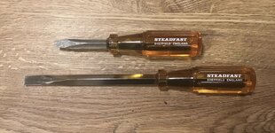

Ahh, I see we have another admirer of Steadfast! One of my favourites too. I’ve a few in the collection, and some that I regularly use. Here are a couple with square shafts. I love this pattern. Very heavy duty!
I remain to be convinced though, that Steadfast made the Britool screwdrivers. Steadfast made several patterns of handle, but I don’t think any are identical to the Britool. The fluted ones I’ve seen are subtly different, and the ribbed ones like ours are very different.
The handle colours are different too. The amber colour of the Steadfast is a deeper shade than the Britool that I own.
I agree it would have made sense though. Steadfast were a screwdriver specialist, and not a competitor, so a logical choice.
The Britool drivers do seem to be similar to the Gordon and Footprint. Gordon would be a weird choice, but I have some with handles identical to the Britool in shape, size and colour.

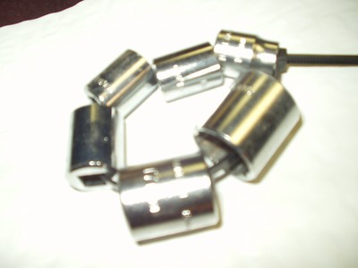

Here are 5 sockets on parade for inspection and comments.
From L to R
Left one is a British Made 14mm 3/8 drive ABM14
Next is a British Made 9/16” 3/8 drive AB562.
Note the 1955 date and broad arrow.
Does anyone have a more recent dated example of a British Made Britool.
I’ll revise my opinion that this is the last year of British Made markings if credible evidence is offered.
Next is a Made in England Chrome plated Impact 7/8” drive PEH875
Finally a dual stamped 1 1/8” 3/4 drive HB1125
