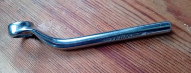

I paid 20p for this Britool 4111 DBE this morning. It's unusual in that it is 5/16" Whitworth both ends with one end off-set and the other flat.
That looks in great condition, is it stamped “Made in England”?
There is a range of these in the 41.. group.
