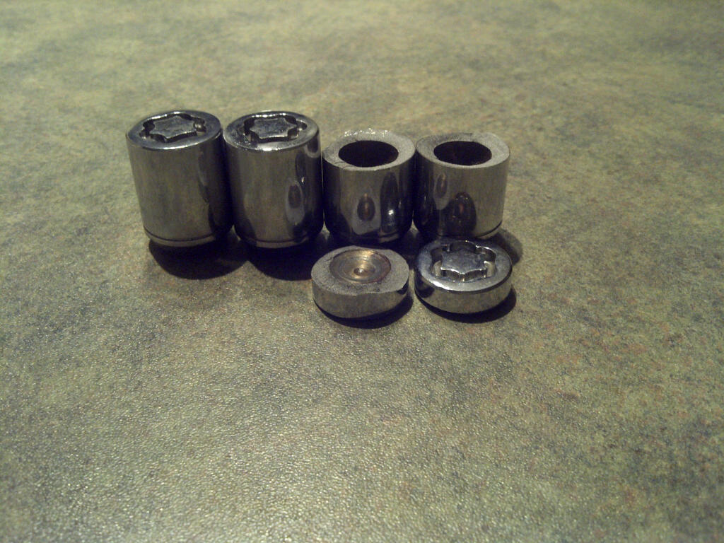

So I'm dealing with a brake problem and while doing the on-again-off-again cakewalk with my wheels, I got to one of my security lug nuts and the socket wouldn't grab it. I took a closer look at the socket, and half of the damned security pattern on the inside has chipped off. The security lugs are round on the outside and have a female pattern on the inside that the male pattern on the inside of the socket locks into. Then you attach a 21 mm socket on the exterior of the security socket to turn it.
Anyway, I'm now left with a truck with bad brakes in the garage (thank the Lord this didn't happen roadside in the rain). There are four fully-tightened security lugnuts on the vehicle, and as (bad) luck would have it, my other 4runner's socket doesn't fit the first one. Any ideas on how to get the lug nuts off?

I'm not sure if I'm going to be able to smash a socket or a nut remover on all four lug nuts. For one thing, the lug nuts are cylindrical on the outside. Welding a nut on would be fine, if I had a welder. Similarly, an air chisel could work, but I don't have air.
Anyway, wouldn't it be easier to remove the intact nuts somehow? Isn't there a tool or specialty socket out there for doing this? :(
I'm going to call the dealer and see if they might have a socket that I can buy. As soon as I get these off, I'm putting regular sockets on.

Those are the easiest to remove. Get a 19mm 12 point 1/2 socket and hammer it on as hard as you can. Then get your impact or breaker bar and remove. To get the wheel lock out of you socket, put it in a vise and hammer thru the socket with a punch. If 19mm is to big or small substitute with what ever size fits. Sears also sells a wheel lock removal kit. I have it it works good/

I've beat a 5/8" 12 point on one before with a mini sledge. Then take it over to the vice and use a punch to get it out.

Take a sharp good sized cold chisel.
Start at 12 o'clock and apply hammer blows to cut a notch for the chisel to dig into.
Tilt rear of chisel to right slightly and apply hammer blows to break loose nut then spin off by hand.

You can order a replacement removal tool if you have the registration number for the nuts.
Otherwise just hammer a cheap socket on them.

No you didnt! they broke because of 2 things..
1....you bought cheap cast iron **** lock nuts!
2...Look at the pics... you can see that the wheel stud has bottomed out into the end of the nut ... you kept on tightening them and "ping"

Those appear to be OE, you can probably buy a new key socket from the dealer but, it won't be cheap.
Those are McGard (IIRC) so I kinda doubt the dealer can do anything, aside from order another key from McGard and mark it up further, they're still going to have to order it. I don't have that kind, but if you're lucky, maybe the key code is stamped on that key, if not every customer I have with OE ones still has the package with their old lug nuts in it somewhere in the car, and the key code should be hiding there. Might as well order a spare for the other one if you're going that route.

Okay, thanks for all the input, guys. Here's what I ended up buying:
This is the Performance Tool Lug Nut Remover Socket Set #M980 - two made in Taiwan impact sockets (13/16" and 1") made of Cr-Mo. I payed about $16 at O'Reilly Auto. These are supposedly made for the express purpose of removing locking lug nuts without a key socket. The 13/16 fit my 21 mm lug nuts, so I figured I'd go with the right tool for the job.
Unfortunately, I do not recommend them. By the time I got the first two lug nuts off, the socket had stripped out the internal threads and just spun when I tried to tighten it (I was hammering it on hard with a 3 lb hammer and turning with a breaker bar). I drove back to O'Reilly and exchanged it (no problem).
Operating on the assumption that maybe I shouldn't have hammered on the first socket - which doesn't seem like it should be a problem, given it's an impact socket - this time I played more gently and hand threaded on the socket until it bit, then turned it with a 1/2" ratchet until snug, then applied my breaker bar. The next lug nut came off fairly easily. However, when I started on the fourth lug nut, it was clear that the new socket had once again stripped off about half of the internal threads (they were sitting in the bottom of the socket well).
O'Reilly was closed at that point, so I kept leaning on the socket. It was catching on only about half of each turn, but it was putting a little torque on the socket each time before popping free. Eventually, all the weak tugs on the socket added up enough to break it free and I got number 4 off. I'm going to return the useless socket set to O'Reilly tomorrow, hopefully for a refund. It's a real piece of ****.

Glad you got it off. Either the steep angle fluted nut removes or the spiral one like you got work, I've used both.
Don't EVER EVER use an impact on locking lugs. Putting them on or taking them off. I've watched people's look of dismay as they found that out. You (op) might not have done it but the PO probably did.
