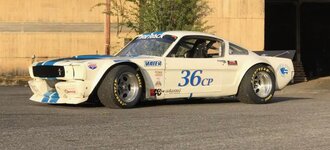

OK, the Mustang project is a 1965 coupe that I picked up to build into a road race/autocross car. I have been doing autocross, open track and some time trials for close to 30 years in an 84 Mustang. I have always wanted an early Mustang track car and I picked this one up to turn into my race car (call it a retirement gift to myself as I finally retired after 40 plus years as a design engineer last year). I have always liked the wide body 65/66 Mustangs race cars like the attached 65 Shelby look alike car, so for my car I wanted a wide body also. I also wanted what I will call the classic look wide body like the attached car. I called Maier Racing out in California and got a full front and rear set of their fiberglass 65/66 race flares (the molds for my flares were pulled from an earlier, somewhat smaller tire version of the white car in the photo). I decided to use the current GT-1/Trans Am tire and wheel package of 14" wide front tires and 14.5" wide tires. Well I found out that the Maier rear flares were not big enough for the 28" tall, 14.5" wide tires (I order my flares a sometime back when the tires were a bit smaller), so I decided to make my own handmade metal rear flares that are somewhat styled after the Maier flares. The Maier flares are more cut away in the front and rear than what I made as I was thinking that more of a full flare when be a bit more aerodynamic than the cut away flare (like a 65 Mustang is aerodynamic). Well, a couple of things have changed since I did the rear metal flares. First, after needing to load the car in and out of my trailer a couple of times, I decided that the car was too wide for its own good (the car had ended up so wide that I only had about 1" or so clearance a side between the tire side walls and the trailer fenders). I knew that this would be the case but I did not know how big of a pain in the rear this was going to be until I had loaded the car in and out of the trailer. I looked at what could be done to move the tires in and found that in the rear, the only way to get really do this would be to move the rear frame rails in (I had already put in mini tubs in the rear). Moving the frame rails could be done but it would be a big pain and it would make the car illegal to run in the SCCA C Prepared autocross class (in CP almost anything goes but moving the rear frames is not allowed). I decided to change the car to run square (same tires and wheel front and rear). This let me reduce the width so that I will have about 2.5" of clearance a side. I am only giving up about 1/2" of tire width and will have a lot less issues living with the car. This is why there are green tape lines on the rear flares in the photos as the flares are too wide now and I plan on cutting them back. I am also thinking that with the narrower track width that I may go back to the more cut away classic flare look, which shows in a green tape line in a one of the photos. I may find that the flares will be too big with the smaller tires (it will depend on how they look), if this ends up being the case, I may cut off the steel flares and go with the Maier rear flares which should fit now. I am hoping this is not the case as it would be a pain to have to redo all the work I have in the rear flares. Another nice extra for going with the smaller, shorter tires is that it will save me a large amount of work with having to notch the bottom of the rear frame rails for rear axle clearance at the ride height I want to run. It has been a lot of work to make a 60 year old car work with today's rubber.
The car will also have a one piece tilting fiberglass nose on it. I can dig up some nose photos and maybe a short video of the nose tilting (if the video would fit here) if anyone is interested. If there is eough interest I could also make a bit of a build thread showing other things done to car like suspension and and other structural mods.
