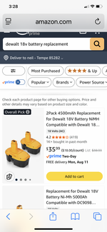

Where can I find the best 18 volt Battery for our 18 volt Dewalt shop vac?
Links would be appreciated.
I don't see a way of using an 18v to 20 volt adapter.
I don't have a clue what's out there for 18 volt batteries. I have one 18 volt lithium that seems to be OK.
The vac has a cover that snaps over the battery

I have tried 3 different aftermarket nicad or nimh batteries for my DeWalt 18v stuff over the years. Each of them were the highest-rated on Amazon at the time. None of them had more than half the actual runtime of the originals. I'm debating whether to try lithiums from Amazon or take my dead packs to Batteries Plus for a rebuild.

The replacement batteries should put the originals to shame. Key word is should.
I guess I’ll try the twin pack of Amazon batteries.
My biggest fear on those batteries is fire.
I really need an outdoor, fire resistant, charging station

Recently got a 2 pack on Amazon. Want to say like $35. No complaints or fires yet!

My experience with the knock off 18v batteries is they don't last worth a damn. You sure the 18v to 20v adaptor won't work on the vac? 20v is kinda a marketing scheme..it's more of a peak voltage..it is really 18v working power..so if you can get the adaptor to fit there are always deals on real DeWalt 20v batteries...
