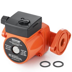

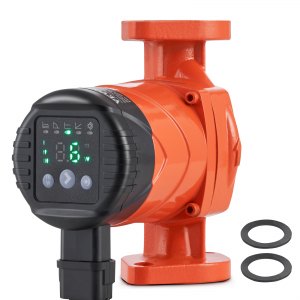

Also with cost of electricity as it is, I would dare to say how could you afford a cheap circulator pump these days? It will cost you much more over the lifetime compared to a grundfos alpha 15-58F or taco 007E do to their efficiency.
As far as running straight water, it only takes some one to leave a door open on a shop during really cold weather to freeze the floor by the door and ruin the floor. Or equipment failure that you can get replacements for the vevor stuff as they don't make or maintain anything. I would never run water in a shop/garage.
The Metric System
Apr 28, 2025
286
Fortunately there is a $55 Vevor version of the 007E:
