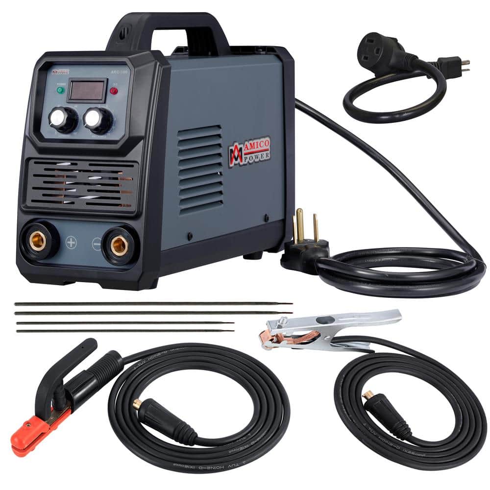

vpd66
Mar 1, 2010
710
Central Wisconsin
I have one of these.
ref=sr_1_5
I can't believe no one has suggested one. Its a 160 amp inverter stick welder. It will run on 110 volt or 220 volts. Of course it has more power on 220 volt. I bought it for the time someone calls and says can you come over and weld this? It runs 6013,6011, and 7018 rods real nice. The best part is it all fits inside a 5 gallon pail!
