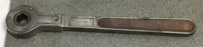

Here's a good example that was posted last night on Ebay:
Bethlehem 1.2 hex drive ratchet for 'Set D' (Bonney made) (Ebay 162808263404 01).jpg Bethlehem 1.2 hex drive ratchet for 'Set D' (Bonney made) (Ebay 162808263404 02).jpgBethlehem 1.2 hex drive ratchet for 'Set D' (Bonney made) (Ebay 162808263404 03).jpg
Bethlehem 1.2 hex drive ratchet for 'Set D' (Bonney made) (Ebay 162808263404 04).jpgBethlehem 1.2 hex drive ratchet for 'Set D' (Bonney made) (Ebay 162808263404 05).jpgBethlehem 1.2 hex drive ratchet for 'Set D' (Bonney made) (Ebay 162808263404 06).jpg
^ This one is particularly egregious, because what little, if any, of the original "copper oxide plating" that was on the item has been removed. I find stuff like this on Ebay all the time and my first thought is "IDIOT!"

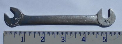

This one I wiped down with some laquer thinner and #0000 steel wool to remove the rest of the paint overspray. Bear in mind this piece is a "user" - I use it to remove carburetors from old Tecumseh mower engines:
