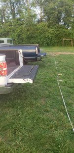

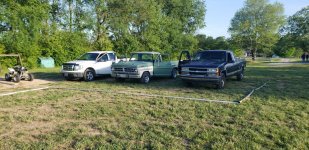

hey everyone, I'm in middle tn/nashville area, I'm in the process of getting a 30x50x14 pole barn style garage. I layed pvc pipe out to get a visual of the garage.
I'm doing 3- 10x10 garage doors in the front

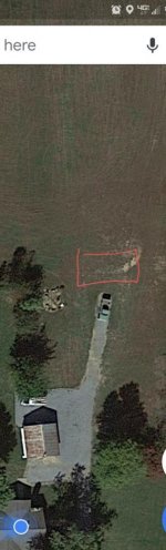

(long side )and 1 10x10 garage door in the back. 4 foot from edge of wall to first door and 3 feet between doors so the vehicle doors don't hit each other I got that info from here thanks, this garage will be mainly for working on vehicles not storing. im going 14' tall to accommodate a lift at some point, I know its gonna fill up quick I'll have about 5' or so between my truck and the tool box. I always wanted a pass-thru door whats yalls opinion on that. I'm also having a little bit of a difficult time exactly where to put it. I have 5.8 acres, right now I'm looking to be 150' from the house. would yall go closer or further etc. I'll try and post pics of property etc.
But here is my biggest concern which is the grade I'm about 17" differences on the long side the garage doors side, so basically if I do nothing,one garage door will be 17" off the ground. I had one guy come by and he said he would just dig the high side down, I'm thinking, wouldn't you still have a water issue water flowing down grade. So is it better to dig down the high side or bring in dirt and build up the low side. I would love to go bigger 40x60 would be ideal but budget want allow it im just greatful to be getting a garage its been 3 yrs in the making.
Thanks for any input

The 150' seems like a long way to me, I am assuming that you are going to have electricity and that's a long way to trench underground plus large wire sizes to guard against voltage drop.
I also think it would also be good to have an open bay at one end or the other, nice for working outdoors when you want to paint, weld, or even hang out and BBQ and have a roof overhead. Seems simple enough but I'd cover the underside of the roof in enough places to exclude birds.

My site dropped a LOT more than I *GUESSED it dropped and getting the site work done was darned near as costly as the steel package. An important part of the planning will be site prep, which will likely involve moving/replacing/adding/packing/leveling dirt or fill material. I would look to established local dirt work guys for an estimate/site survey/suggestions on how they would proceed.
Personally I was shocked at much fill I didn't know I needed(!)
Unless there is a pressing reason (WAF?) to locate it that far away, 150' is a long darn way. You're right on the cusp of the walk vs drive decision and you WILL BE making the same calculus a hundred times a month from this point forward.
(you'll also end up with a golf cart)
150 foot is a lot of extra expense for wire/conduit/labor/ driveway material/labor.
EDit: Looking at your sketches, my preference would be similar to the BLUE location shown, though I have no distance reference. OR
Within that wood-lined square closer to the house(!)

Personally, and as already mentioned, if you plan on being there into your older years I would have that pole barn reasonably close to the house especially when considering rainy weather, snow /ice. If you can help it I would also look at situating the pole barn in area that is relatively level or at least an area where you can also minimize any compacted fill if required. I wouldn't be cutting grade if I could help it. I would probably rent a level and grade rod and mess around and gets some grade shots to get an idea of the lay of your land. If you have never used one it its pretty simple to learn. I would probably set the potential finished floor level like 6 inches above the highest existing adjacent grade.
As someone already mentioned it can be shocking when using a level how quickly grades can change. Reminds me of in college and taking surveying and looking through the level and sometimes not even being able to see my rod-man with a 13 foot ? high pole, a shocking lesson learned as a newbie.

Thank yall for the input, I see alot of people worried about the distance actually I wanted it even further back, the reason I want it back so far is privacy, that way people can't see inside going down the road etc, etc, or see the junk we accumulated around the or behind the building. I can always drive a vehicle to the building or something. Distance definitely not a big deal, also I'm an electrican so the distance for the electrical is not a problem already got that figured out. At some point i will be adding a lean to on the back. Not doing over hang mainly dont see a need, plus its not in the budget. I will have gutters. In this picture is where I have it layed out at the moment. I also made a water level, which works very awesome and very accurate. I can check around 75 feet with it.
