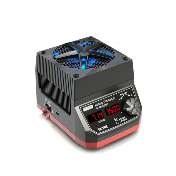

First question like others asked, what is the capacity of the batteries ? There are a number of battery analyzers sold for Radio Control Model Airplane use. One of those might do the trick. Here are two examples :
I think those are going to be for rechargeable batteries. I have a similar analyzer that basically discharges the battery and then tracks the current input when it charges it back up. These are single use nonrechargeable so to analyze them with a discharge we would turn them into junk.
