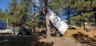

I had a slope to deal with when I built my pole-barn hobby shop. My shop is 72 feet along the back wall and 48 feet deep. See below
The high point is the upper left corner of the sketch - lowest is lower right: 7.5' height differential.
The gate on the now-gone fence line about equals the location of my 16' garage door on the finished product.
BEFORE
DURING - you can see some of the fill dirt on the right

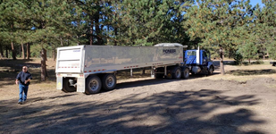

To get a flat base I had 1,154 tons of fill dirt trucked in. It took 46 of these trucks (carrying 25 tons each) to get there.
This perspective also shows just how much fill needed to be trucked in to level the construction site: 1,154 tons of dirt. The near corner in this pic has 7 to 7.5 feet of fill.
My GC said that whether I brought dirt in or took dirt out (and include a small retaining) was about a wash in cost.
Since I have a heavily treed lot (like yours), taking dirt out / rising a retaining wall risked a lot of roots getting in the way.
Also, my GC explained that the corner where the retaining wall would be located would be a great catch point for weather (rain/snow) to collect and potentially attack the wall and the building - a point to consider. You don't mention where you live so the weather may not such an issue for you; I'm in NE Colorado Springs.
I opted to do 100% fill (another cost consideration is how you compact the fill to provide a good foundation point.

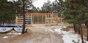

AFTER
When all was said and done, my GC said I needed to drop a bunch of trees or put in a retaining cause the slope of the fill was too steep.
My retaining wall was on the outside of the fill -- no corners to catch moisture.
I have, since these photos, laid concrete and filled the area adjacent to the shop with rock
