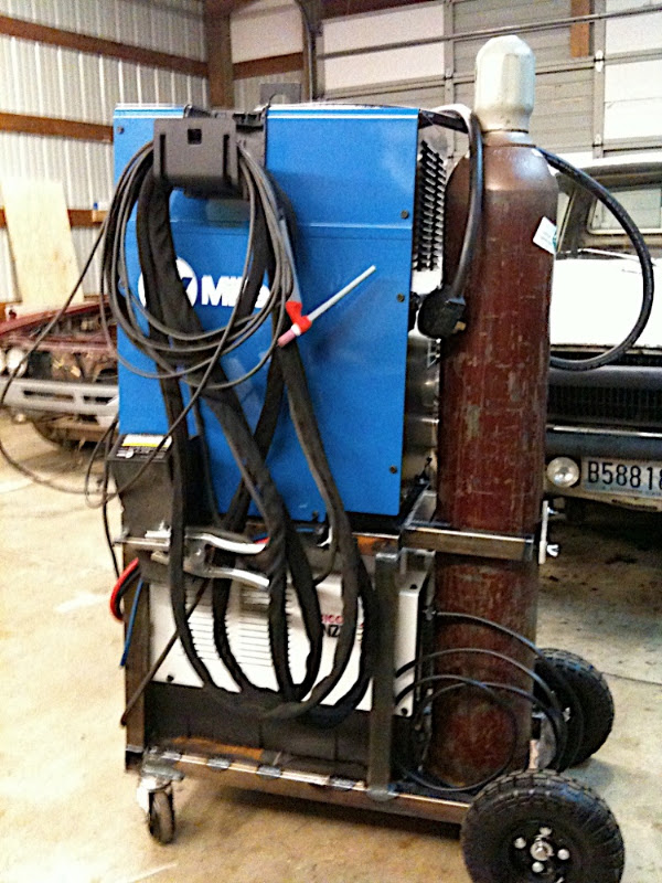

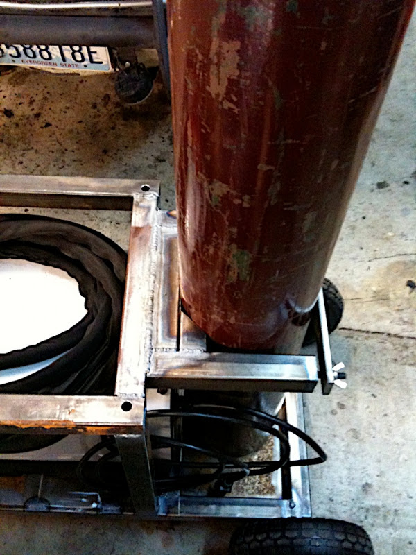

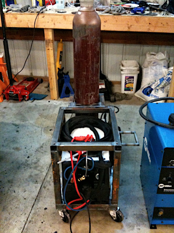

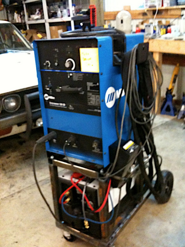

slodat
Feb 6, 2010
3,682
Central-ish, WA
I made this cart for my TIG welder and water cooler. The argon bottle is held in place by a clamp. The fixed side of the clamp has two pieces of mitered tubing welded to another piece of 1.5" tube. This cradles the bottle quite well. The bottle is held in place by a piece of 1.5" x 3/8" bar and two wing nuts. It sits in a pan on the bottom of the cart. The sides of the upper support are intentionally about 3/4" shorter than the diameter of the bottle so that the clamp holds the bottle. It is very secure and a dead simple design. I'm happy with the end result.
Please go easy on my welds. This is my first TIG project. I know I have a lot to learn. My approach was to make the cart the best I was able and learn from it.
