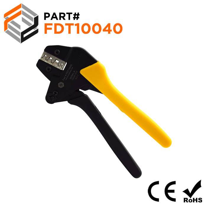

Can someone please clarify what terminal crimpers I need to build automotive relays as I have pictured?
From what I can gather from the insanely overcomplicated subject of crimping, these are uninsulated “quick disconnect” terminals that can also be referred to as FASTON? terminals?
I’m sure you guys will be right along to inform me of at least another thousand or so names for these things.
Bottom line is I need to know what terminal crimpers I need to build the relay pictured and please let me know if it matters whether my relay is using .250” terminals or the smaller .110” terminals?
Do they require a totally different set of crimping dies?

At the bottom of the website page you are showing, they have the spare terminals that detail they are Metri-Pack 630 Series terminals. You need a special crimper with a die specifically for the Metri-Pack 630 terminal AND wire gauge size. (The crimps will be different.)
This GM booklet has the OEM part numbers for the terminals: https://www.weber.edu/wsuimages/automotive/j-38125-620b terminal repair booklet.pdf
^ You can use the booklet and tables to sort through all the terminals and find your part numbers. The tables will also give part numbers for the Delphi crimpers. You can often get good deals on these through eBay or you can find generic versions also.

There are many different types of crimp systems, far too many to make a comprehensive list.
Even the same type of terminal (like your 0.25" Fastons) can require a different type of crimper on the wire end depending on things like whether it's single or double crimp, straight vs flag, or the intended wire gauge.
Often the crimpers are manufacturer-specific, so otherwise interchangeable 0.25" Fastons made by Molex might specify a different crimp tool than ones made by AMP.
These crimp tools are expensive and generally only suitable for use on one particular type of crimp. They are worth every penny in an industrial application where you are making thousands of crimps a day without much time to inspect each one and where rework is a big process issue.
IMO they are overkill for a home/hobbyist application, and with a bit of practice and care you can get good crimps with this style of inexpensive ratcheting interchangeable-jaw crimpers.

So far I’m hearing Fastons and Metri Pak 630’s yet never once have I seen a “metri pack 630” or “FASTON” advertised crimp tool.
I guess I just thought there’d at least be some standard terminology more commonly used for these crimps/terminals which have been used forever in numerous industries.
Be that as it may, I’m replacing a couple FASS fuel pump relays. They are 40a relays on 10awg wire. They are overkill and the pumps only pull less than 10a, but that’s what the mfr sends so that’s what I’ll go back with.
This looks similar to the MAC I posted above but they do mention FASTON Type-B in description. I'm sure there are others that do so as well.

The terminals in the OP's initial post are Packard 56 style terminals. Use a correct Packard 56 crimping tool. I have a set of MSD jaws in a generic crimper tool frame that do a great job on these, including crimping both the conductor and insulator at the same time. The result looks just like the OEM crimps. These are NOT MetriPack or anything else, they are Packard 56.

So the correct tool is a generic tool?
How did you get that from what I wrote. One more time, MSD sells different jaws (dies) for different terminals. One of them is P/N 3509, which will make the correct crimp on Packard 56 terminals as well as on WeatherPack terminals. These dies fit into most generic ratchet crimp frames that are set up for replaceable dies. I got a generic frame at a swap meet for $15 and the MSD dies fit fine. You can also pay stupid money for an official Kent Moore Packard 56 crimp tool. Personally, I'm cheap. The Kent Moore tool in the last photo is currently $285 on ebay. Too rich for my blood.
