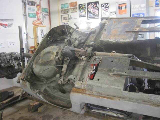

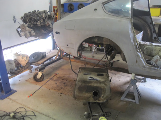

Worked hard today to get er done! The scene:
Had to pull the tank out to get the rear bolted up (and to avoid spilling any remnants of old gas!):
Front end attachments:
Rear end attachments (spoiler alert!):

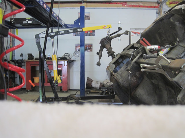

Here we go!
Woo-hoo! It actually turned over on it's own due to being slightly top heavy (wish I had seen your "heads up" Robert!). I think once I remove the rear end gear, it should even out. I did plan it this way as I didn't want to remove the running gear lying under it, but I'm sure you should have a shell stripped before twirling!
