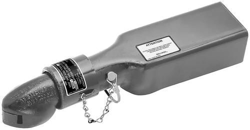

ummm... the trailer side uses a FIXED/SOLID loop...
Are you sure you have done enough research to do this correctly/safely?
Pintle hitch is really easy to steal just use a section of chain and a paddalock
chain it to the hitch and off you go.
A bulldog hitch and the properlock for it is much harder to steal then a pintle hitch.
lock for bulldog

I have the lock shown with a bulldog hitch & have never had a problem. I live in Baton Rouge & go to New Orleans often. Between the two it is possible to have the anything stolen from your car or trailer. Also wrap your safety chains and lock them so they can not be used as a quickie tow method until they can get it some where to attempt to remove the lock.

wow, now I don't know what to do, we had an equipment float with the bulldog hitch, but it walked too. I may re-consider my approach with the hitch assy. Im not that savvy when it comes to this type of thing. I usually see ball type hitches mostly. I just assumed a pintle style configuration I could remove would be a good idea. I also assumed the tow relationship with the pintle was the same under load, perhaps its not. I can still change it out at this point. Im glad I asked : )
You can buy removable lunette eye assemblies.
