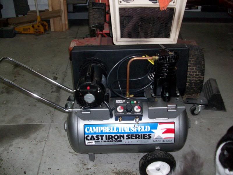

I helped my dad get an old water heater out of hi friend's house, and a new one down into the basement. His friend asked me if I wanted a compressor that he had never and was never going to use. I said sure! He said that this thing is at least 15 years old, but has never been run. I got the compressor, a bag with some fittings, rubber pads, and a hose, and the original paper work. I haven't looked into the manual yet, but I am guessing that from the size of this thing, it won't be good for much more than keeping all my tires aired up, and maybe running my nail guns for certain jobs. I currently use those guns with a pancake compressor that is easy to carry around. Anyway, for an unused USA-made compressor to fall into my lap for free, I am stoked!!

I filled the crankcase with SAE30 oil and then ran through the break-in procedure, as called for in the manual. Basically, you crank the regulator valve all the way to the right (or is it left? Forgot already) and let the thing run for thirty minutes. You then crank the valve the other way to let the pressure build up and make sure the auto shutoff works.
Everything worked well. It's not too loud when it's running, either.
I connected the sort of dinky rubber hose that came with it instead of the 50 ft Goodyear hose that I have, because the Goodyear hose has male ends and I need to get some kind of adapter to connect one end to the male threads on the outlet.
I aired up the tires on four vehicles. Then I drained the tank down to about 10 psi and opened the petcock all the way. Not one drop of water came out.
Checked the oil level and saw that it had gone down a bit during break-in. Topped it off and put the compressor under a tall work bench.
Pretty sweet.
