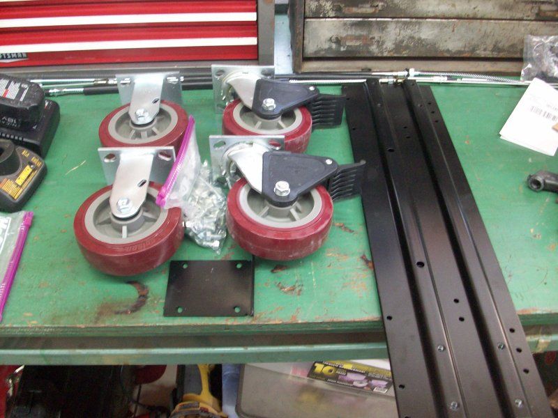

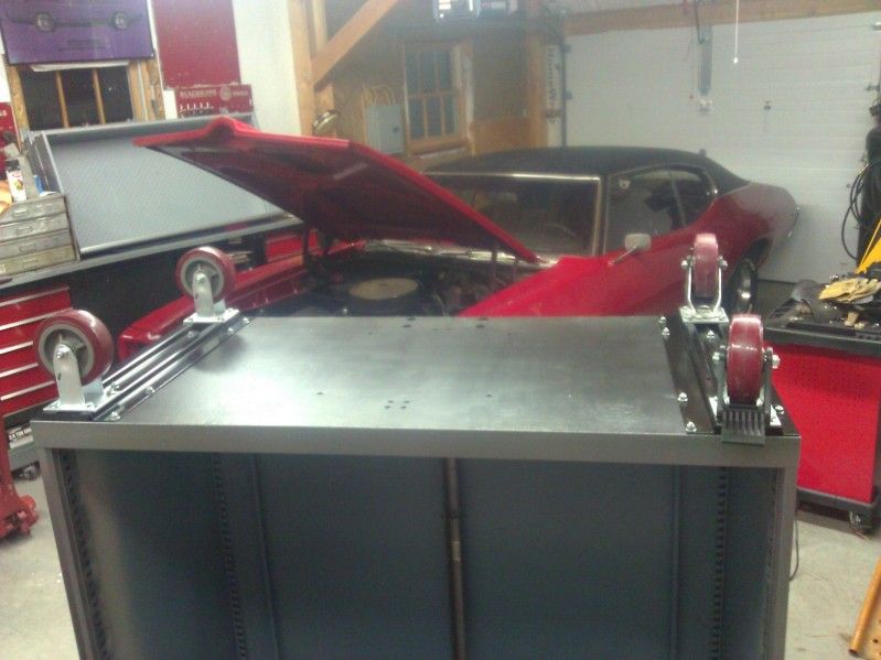

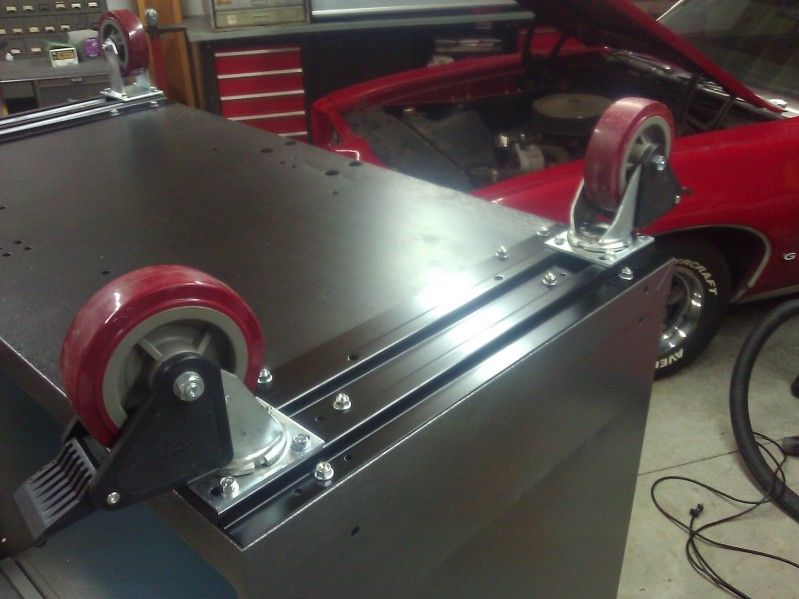

Bull,
I picked up a DW Mobile Base Kit for you today at LISTA. The kit consists of two waffle plates, to fixed and 2 swivel Colson casters, and 4 end plates to hide the "waffle". I'll pull together the hardware for you also.
The 2" x 6" casters are the heavy duty ones which are rated at 900 lbs. each for a total weight bearing capacity of 3600 lbs. The entire assembly will raise your DW1050 cabinet 8" for a total height of 53-1/4"
The plates bolt to the bottom of the cabinet and the casters then bolt to the plates. An easy few minute installation.
This should also help to shed light on how the Lista bases are implemented. Hopefully others will find this useful.
I'll PM you on this.
Joe

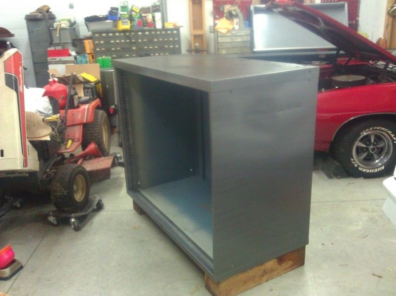

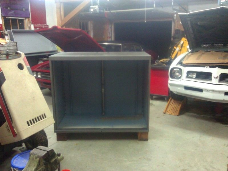

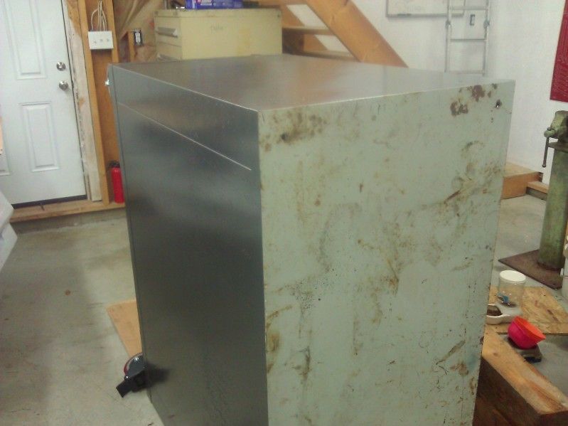

So I haven't touched the box since last weekend. I absolutely have zero time during the week to work on projects. When I got to the box this morning, I was NOT pleased to see rust already coming through the silver Master Series paint I applied to the bottom. This is AFTER the scale and loose rust had been removed and the entire surface treated with Ospho rust converter. Not cool. I sprayed one coat of black paint to the surface to hopefully offer some more protection and close up any pits, but I'm not too hopeful about this.
I went over the whole box again with a random orbit sander with a 100 grit Diablo hook and loop pad. I then cleaned it all twice with mineral spirits and started spraying the Rustoleum Hammered Gray. I very much wanted to ROLL the paint from a quart can rather than spray, using a dense foam roller and thinning the paint. I wanted to thin it because I have read some reviews where people said the Hammered stuff dries super-quickly, and their rollers were pulling the paint from the surface or making a mess of it as they worked an area. Well, the local Home Cheapo had every color in quarts EXCEPT gray. Ballz. After spray-bombing the box with a few coats today, I am not happy with the results. It's zebra-stripe city. The surface area is too large and the quality of the spray pattern too low to achieve a smooth, even finish. I guess I am going to have to order a quart of gray and roll one more coat before considering this "done."
Rust coming through the Master Series
Shot of the front of the slides, or whatever these are called. I removed all fourteen of these before spraying today.
The plastic clips that help secure the front of the slides to the box frame.
Each slide weighs 3.4 lbs. That's almost 50lbs in just these pieces alone for this box.

Joe, I agree: someone rode this box hard and put it away wet.
I considered smoothing pits and dents and whatnot, but as it is this is more effort than I intended to spend. For two weekends now, I have fiddled with the box instead of working on the drywall in my garage. It will be worth it, though.
The Master Series paint that I used is a product similar to POR15, meant specifically for rust encapsulation. I don't know if it failed a bit because the paint was very old, or because I did only one and not two coats. In the future I might try that Rustoleum rusty metal stuff you guys are talking about.
10-4 on the ATF for the U-channels. I actually have a bucket of used stuff. I'll brush a little on each channel before reinstalling them.
I hope to have this whole project buttoned up by next weekend. I need to add the mobile base, roll a final coat of the Hammered gray, line the drawers, clean the bearings on the carriages and then oil them, and put everything back together.
I'm pretty excited because this large box is going to allow me to get some smaller boxes and other organizational pieces out of my garage and regain some space.

Joe, this project would be a lot harder without you. Thanks for giving me the pics and that diagram.
Here are the parts I got from Joe. The waffle plates and casters are just of beautiful quality.
I wanted to have those pieces mounted by early evening, but family demands made that impossible. I was just able to get the cabinet into the garage a few minutes ago, using my handy-dandy Escalera forklift cart. The box looks even bigger inside than it did outside.
I hope to get back out there later tonight to get at least one plate and caster setup mounted. I want to flip this over and prep/paint the top tomorrow, and also clean up/paint the rusty areas inside on the bottom. By the end of the weekend I'd like to have the drawer faces waxed, the carriage bearings cleaned and lubed, and those pieces all actually positioned inside the cabinet.

Just got back in from the garage. I installed the waffle plates and casters and then flipped the box right-side up. Tomorrow I hope to have some time to finish painting it, but we'll see.
You can see the top in this pic of the cabinet on its side mid-flip. The Rustoleum hammered looks a heck of a lot better than the abused and neglected original paint. Hopefully, one more coat rolled on will make it look even better.
