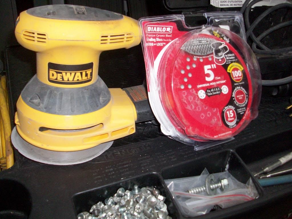

Well, you win some and lose some. Today, I lost a bit.
I spent some time yesterday getting one of the boxes up on some saw horses so they were at a more comfortable height to work on. I then spent some more time sanding one down with a random orbit sander and some 100 grit sanding pads. My goal was to feather any big edges, scuff every inch, remove any loose rust/paint, and sand around areas where there was rust of any kind, so it was all exposed.
These Diablo pads are really nice.
That was all well and fine. I went over the cabinet twice with hot soapy water and a sponge to get rid of sanding dust, and one final time with a rag and mineral spirits.
I was excited this morning to get two coats of paint on the cabinet and then, later in the day, move it into position. See my top-hat heater in the pic above, in front of the saw horses? I just picked it up a couple weeks back and this was to be the inaugural run. I need to get the temp at least into the 60s to paint, and it was only 43 in the barn today. I read the manual for the heater, connected everything, and sprayed soapy water to check for leaks. I didn't see any, so I fired it up. It was humming along nicely for a minute or so when I decided to do a final leak check, sniffing and spraying the fittings at the heater and working my way back to the tank. Well sure enough, at the tank I smelled gas. I turned off the valve pronto and sprayed some more soapy water. I got a lot of bubbles at a crimped connection on the heater side of the regulator. It looked like a Spittle Bug's nest in no time.
That really sucked. I need to find a new hose and regulator, preferably USA-made. But since I had no heat, I couldn't paint a darn thing. This puts me behind where I want to be on this. Grrr!
Any of you guys know a company that makes good propane regulators with long hoses, maybe 10+ feet?
