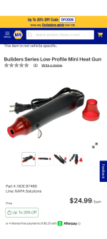

I know you were asking about butane torch. For heat shrink tubing I prefer a small dorman heat gun I got from NAPA. Works great for it's size and price. May not be good for your other possible uses but I find it very usefulScreenshot_20260125-105033.png

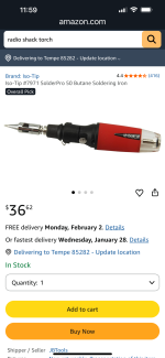

Ive had a few of these. Back when i was soldering and heat shrinking wires 8hrs a day. Used to be available @ radio shack. Great little torch. IMG_0010.png
