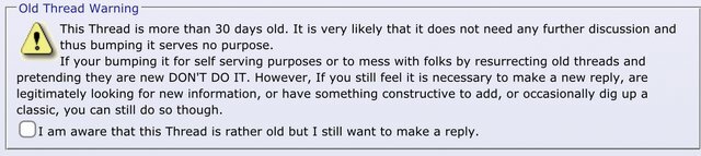

I don't really understand the point of these new accounts that just resurrect old threads for no reason, It seems like an odd type of spam
Usually, it comes when someone searches the site and then clicks on the old post title. Often, that person doesn't check the date, and replies. Then the post rises to the top and others click into it. It's not some deliberate spam thing. Just inattention, really. Not that big a deal.
I was the one who brought this post back up, I was genuinely looking for the video as it came up on a specific search keyword I entered. I was aware of the original posting date and didn't feel that a 4 year old post was very old for a media post. I am new to this forum but have been a member on many other forums for many years. media posts specifically get messed up for a variety of reasons, site updates being a very common cause. I'm sorry if you feel that I was spamming the board, I was legitimately looking for assistance.
