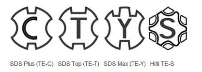

From the Wikipedia link
The SDS bit was developed by Hilti and Bosch in 1975. The name comes from the German "Stecken – Drehen – Sichern" (Insert – Twist – Secure).
The SDS shank has the advantage of fitting into a simple spring-loaded chuck, so that bits are simply pushed into the chuck without tightening. This shank and chucks made for it are especially suited to hammer drilling with masonry drills in stone and concrete. The drill bit is not held solidly in the chuck, but can slide back and forth like a piston; it does not slip during rotation due to the non-circular shank cross-section, matching the chuck.
