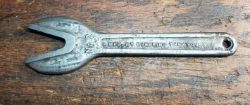

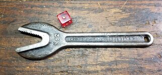

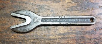

Here's the Roebling "Alligator" - (patent D28270) - note "JAR" (John A. Roebling) logo stamped below gullet.
And a Musselman (patent D120489) - which looks nothing at all like the patent drawings.
And a Forsyth "alligator" style wrench. (Forsyth Industries Inc., 1255 Niagara St., Buffalo, NY / Forsyth Mfg. Co. / Forsyth Metal Goods Co., East Aurora, NY / http://forsythindustries.com/ / Patent 593543 Nov 9 1897 H.B. Rose (pin spanner) / spanner, alligator wrench / (only because I ran across it looking for the Roebling.)
The diminutive size of the Roebling unit brings into question my speculative suggestion above that those openings may have been intended for turning nuts, but considering the era during which they were made - when bicycles were all the rage - those small openings may well have been adequate - compare them to the openings on the Musselman unit just below.

Picked up another No. 2 at the flea this morning. (See post #65 for the first one.) Potential trade material. Kind of scruffy, but someone may want/need it.
