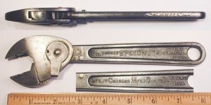

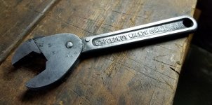

I found this SPEEDNUT WRENCH CORPORATION “SPEEDNUT” wrench at the flea market on Thursday morning.
I just took it out of the de-rusting bath and lubed it up and snapped some pictures.
If you’ve never seen one before, there is no thumbscrew or lever or any other mechanism to open or close the dynamic jaw. You don’t even need two hands. It opens or closes by just turning the wrench over one way or another in your hand, with the weight of the dynamic jaw doing the work. It is literally that easy and that smooth.
The capacity is 9/16”...
...to 1-1/16”.
That little arm and pin is used to lock or un-lock an internal torsional spring that provides tension, or not, on the dynamic jaw. The original SPEEDNUT wrench, first made and sold by the Cochran Pipe Wrench Manufacturing Company in 1914, did not have this mechanism. Here it is in the locked position.

SPEEDNUT wrenches pop up from time to time on GJ in various guises, but they typically elicit a few ‘oohs’ and ‘ahs’ and ‘I got one of those from my grandfather’ and then quickly peter out. Even a thread on the Cochran SPEEDNUT wrench that sprung from one of Ryan’s 2012 Blogs, linked here, didn’t last long up on the General Discussion board. (If you’re not aware, James Cochran, the founder of Cochran Pipe Wrench Manufacturing Company in Chicago, and the manufacturer of the Cochran SPEEDNUT wrench, was our founder and Administrator’s ancestor.)
So I did a little research. They were made in a few different styles for a number of years by a dizzying variety of manufacturers. I have not worked out the entire timeline, but I have lined up some of the major milestones. The relationships between the various manufacturers, if any, is not known. Right now that is in the category of ‘Needs More Research’.
Starting at the beginning, it looks like the first SPEEDNUT was made by Cochran Pipe Wrench Manufacturing Company in 1914. Or at least that’s the earliest reference I can find. (Ryan claims 1910 in his Blog entry, but I am not sure of his source for that. Could be family lore.)

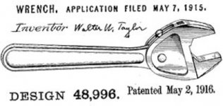

This is where the quandaries and fun start.
The figure accompanying a design patent – D48,996 – looks an awful lot like the Cochran SPEEDNUT. Here is a summary courtesy of DATAMP.
It was issued to W.W. Taylor on May 2, 1916. A link to the full design patent at the USPTO site is provided here. The design patent was not assigned. It has not been established if W.W. Taylor worked for Cochran, whether he was an officer of the company, or whether he just licensed the design to Cochran. There is no doubt that the Cochran SPEEDNUT wrench exemplifies the design.

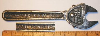

But there is a problem. The Cochran SPEEDNUT wrenches we have seen as examples and in advertising don’t align with the patent chronology.
One model seen has “PATENT PENDING” forged-in on the face of the jaw. Here is an image from AA.
These are thought to be 1st generation.

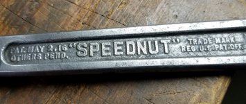

Another model seen has “PAT. MAY 2-1916” forged-in on the shank. Here is an image from Ryan's Blog post.
These are thought to be 2nd generation, with the “PATENT PENDING” on the earlier wrenches a reference to the design patent D48,996 that was later issued on that date. This theory has the Directory of American Tool and Machinery Patents (DATAMP) on its side. A link to their Cochran SPEEDNUT page is here.
The dilemma with this theory, which DATAMP is apparently oblivious to, is the fact that the patent application wasn’t filed until May 7, 1915. Cochran couldn’t have been making wrenches marked with “PATENT PENDING” on the jaw face in 1914. Since he was making and selling SPEEDNUT wrenches in 1914, if the “PATENT PENDING” mark refers to D48,996, there has to be an earlier model out there, probably not marked with any reference to a patent pending or otherwise, making the “PATENT PENDING” wrenches 2nd generation, and the date-on-shank wrenches 3rd generation.

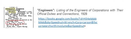

A 1928 book called Engineers: Listing of the Engineers of Corporations with Their Official Duties and Connections names John V. Larson as the President of Speednut Wrench Corporation. This one is also a Snippet View only and very fuzzy, sorry.
