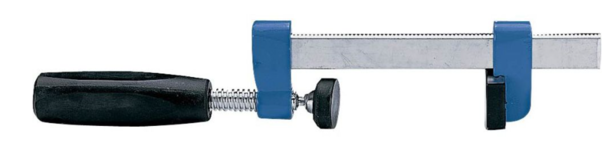

Take a look at Piher Maxipress clamps. Made in Spain. They are my #1 go-to clamp for anything that I can’t use a vice grip for.
Lee
Those are actually really cool! Thanks! The price is quite reasonable over on German Amazon, most normal sized models under 50€!
