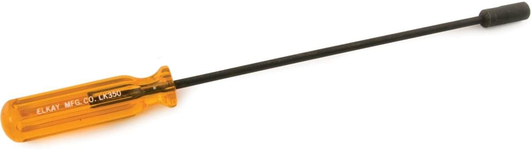

Elkay / Elkay Mfg. Co., 1333 Butterfield Rd., Ste. 200, Downers Grove, IL 60515 / https://www.elkay.com/ / est. 1920 / specialty tools for plumbing trade /
unfortunately nothin' yet on these guys, but something will turn up sooner or later.... always does...

I would say the Elkay driver that is pictured has a straight bladed driver with the centering sleeve instead of a 5/16 nutdriver. It was made to be used on the later self-******* stainless steel sinks. They were made with a small u track attached to the sink instead of the hudee ring. Made things a bit easier too install. Those hudee rings and a cast iron double kitchen sink that always seamed like it weighed a hundred pounds were not fun to install. The self ******* sinks that glued in were a lot easier.
