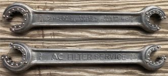

This double Cam Loc followed me home today. Marked TKF Co on one side and Air Filter Service on the reverse. Sizes are 3/4" and 5/8".

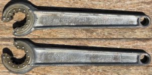

I added an original T.K.F. 9/16-incher to my collection today from the flea market. Probably in the best condition of any I have so far.
