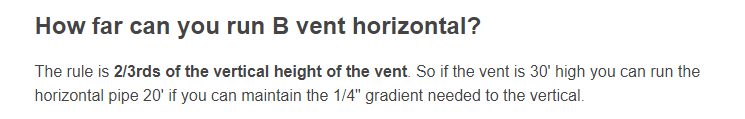

so all of this info is bogus?
Big Maxx heaters have a section in the install manual on horizontal venting requirements. Code typically refers to manufacturer instructions for vent categories other than type 1. Mr Heater states the heater is rated for cat 3 vent pipe in horizontal configurations, so you need to use stainless vent pipe.

It can run nearly horizontal for a distance, but you can't just terminate a horizontal run outside the wall. It needs a vertical run to pull the exhaust up.
B vent needs to operate in negative pressure because it's not sealed. Cat III has gaskets and can be positive pressure.
