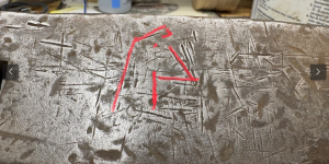

I have been looking for an anvil, smaller, for benchtop use and found this one on FB Marketplace a couple months ago. The guy selling it lives in a town in PA that a friend of mine does so pickup was real easy. I paid $80 for it and the seller gave me like 9 hammers with it, a few ball peen, a claw hammer and a few blacksmith hammers. I would like to clean those up, some rust on the blacksmith hammers and wonder if soaking the heads in vinegar would cause any damage to the portion of the wooden handle in the head.
The to0p surface of the anvil has been damaged in the past, I would like to have it restored to a smooth surface and wonder if a machine shop might be able to use a milling machine to grind off enough to do this?

Somebody did a lot of pretty decent work to turn a piece of train rail into an “anvil”.
If that was mine, I would use it as-is. To smooth out the top I suggest using a belt sander followed by the flap discs already recommended.

Railroad track is a "work hardening " steel. Grind or machine off the top layer and what's left may be softer (almost mild steel soft, depending on how much of the work hardened surface is removed).
Hammer away on the surface and it will work harden again though. But may deform or get marked up again until it work hardens.
I'd say just use it as is until you get to the point (skill level or project demands) where the anvil surface affects your results.

As for cleaning the flat surface with a milling machine, it's an easy job. If you were closer, I'd do it for you.

A friend came by my house to give me a hand wit a few things, while we were in the garage he saw my anvil and we started talking about it. I mentioned that I wanted to get it cleaned up and he said he knew a guy that might be able to help me out with this. He dropped it off this morning and I am very happy with the results. Wish he had evened up the sides and done a little work on the front section but I'm pleased with the overall results. I will be sending his friend a nice adult beverage for his efforts.

For a box of beer face milling the top seems like a good deal for both parties. Cleaning up the sides would have been a bit more work in getting it squared up nicely on the table, then side milling with an endmill. Depending on what tooling he has and how hard it is, it could dull some hss/carbide in a few passes.
The front nose section pretty much would be hand finishing with a grinder or files.
To just facemill you bolt it down roughly square and go to town. Likely wouldn't cause much wear on a set of facemill inserts. 15 min job if you are organized.
That looks like it was fly cut, which is what I would have done. You NEED to clean up the sides and corners. You should be able to dress them good enough with an angle grinder. Try to keep the corners fairly sharp, then dress them down with a file.
Then take the angle grinder (I'd start with a 36 grit flap wheel) to the horn and just blend out some of the nicks, but don't let the local surface become concave, or you'll regret it.
I have a VERY similar anvil. I think mine is a probably a 100yr old GE Forge "Farrier's" Anvil, which I think yours is as well. Farriers' anvils are quite elegant, with long over hangs at the table and horn. They are typically lighter weight for lighter work and transportability.
Last, as you are messing around with your anvil, please keep in mind you own a piece of history. They literally do not make them like that anymore. I bought mine probably 20 yrs ago for around $100. I think it's worth quite a bit more now ($3-5/lb now). In a past life, I worked closely with various tool making smiths (blade smiths). It was my experience that every single one was a multi-millionaire, corporate exec, or member of the secretive american aristocracy who chucked it all and took up the hammer for a simpler life. Preserving the essentials of this trade is smart for SO many reasons.
Thanks for this information, I will have to be careful using the grinder, I have very little experience using on so I amy find some scrap stuff to get comfortable in how to handle it.

You'd have to remove a LOOOOT of metal to significantly clean up most of the corners, and there are large areas on the sides that are really too damaged to reasonably recover. The fly cutting removed a fair bit of metal from the top face, and they stopped at a good point; you certainly would not want to go further in order to smooth out the last few deep cuts.
As @AEAdam stated, you can clean up and blend some of the damage with a flap wheel, but you certainly don't want to try and get everything, since that would move a lot of metal and drastically reshape the anvil.
Anyway, it looks like a nice useful tool, with a lot of history. You really wonder why someone didn't seem to give a hoot about using a chisel on the top face. What in the world were they making or doing?
