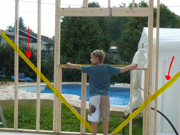

Mine is 16'x30'x10'
I added inset diagonal bracing at every corner except the front where the garage door is.
It will stand for 50+ years easy.
While your stud wall is on the floor and squared, take some 1"x 4" x 12' or 14' strapping (if you're really worried use 1x6 boards); lay them diagonally from 12" ~ 24" below the top plate all the way down to the bottom plate. With somebody holding it at each end, trace the outline along each stud. Lift it off, set your circular saw to a shallower depth (equal to thickness of the board) and cut inside the penciled lines on your studs. also cut every 1/2" ~ 3/4" slicing up the meat in between. Knock all that out with your hammer. Set the board into the channel you've just created. It should need to be lightly persuaded with your hammer as the fit should be well snug. Nail it home with your framing hammer (or screw it in if you're really worried). Trim the excess off each end.
