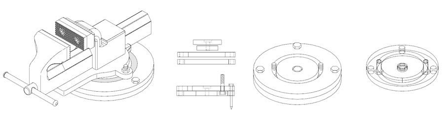

I got what I am told is a Rock Island-for-Craftsman vice. Has anyone make a swivel base for their non-swivel vice? or does anyone sell such a thing?

Yes it's called sell that vise and buy one with a swivel base. Lol
In all seriousness, some vises are easy to add a swivel base to...like Wilton bullets. Vises with ears like your Cman don't have a modular swivel base design.
I'm sure you could fab something up if you wanted but you'd be money and time ahead to just buy the proper vise that fits your needs.

Woden vices has a really nice bolt on base that you could probably adapt to other vises. The big difference compared to most bases it the base has its own top and bottom. It is is not just a bottom piece that attaches to the existing vises base.

I made one for one of my vises. I'm an old fart just learning to run a lathe and weld so it was more of a how to for me and I wasn't worried about the time involved. This is the basics in this photo but you can see the whole procedure in the link below (page 99 post 1070 of the "vise repair 101" thread. You should study other types in the vise thread to see other designs as this is just what worked for me.

If you have to have one then all it takes is a Mill and steel material and some imagination. Here is one for a vise like yours Michael_in_DE. I have made a few but for swivel base vises with a round bottom base. Yours needs one like the first couple pic's.
