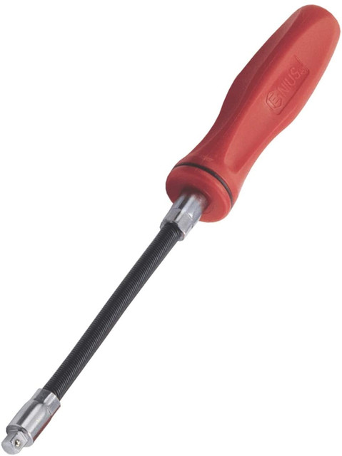

Does anyone know if you can get locking flexible spinner handles like in the picture below? I think a locking variety would be very useful, as I often use mine in very tight / impossible places that would cause a real problem if the socket were to fall off the end.

I haven't seen one. You could permanently fix a short locking extension on the end of the one in the photo. But then it wouldn't be flexible for the length of the extension.

I can’t think of one, but you can get a “locking adaptor” that would fit onto your existing spinner handle and convert it!

you can buy them in popular sizes as in 6 7 8 10 mm etc they were sold for hose clamp nut drivers but i use them for all kinds of stuff

That's no good as I use mine with Koken nut grip sockets, to hold the fastender in place. I like everything secure, so nothing comes loose and drops in an awkward place!

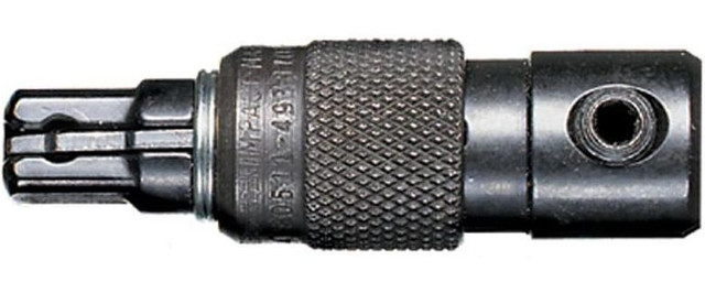

Yes I have seen these (like the photo below) and have found a few options below in various sizes. I just wish somebody made a locking flexible spinner handle, instead of having to buy extra adaptors etc.
1/4"
STAHLWILLE 417/1 1/4" LOCKING ADAPTER
SK Tools Model SKT-40995 1/4" Drive Locking Adapter
PROTO J4759BLS 1/4" Drive Locking Adapter
ARMSTRONG 1/4” DRIVE LOCKING ADAPTER 10-931
3/8"
STAHLWILLE 96122701 LOCKING ADAPTER 433/1
PROTO J5260-02BLS Locking Adapter
Armstrong 3/8" drive locking adapter 11-931
SK Tools model 45195 3/8" drive locking adapter

Not really what you are asking for but if you happen to use 6,7,8mm then you could use a flexible hose clamp driver.

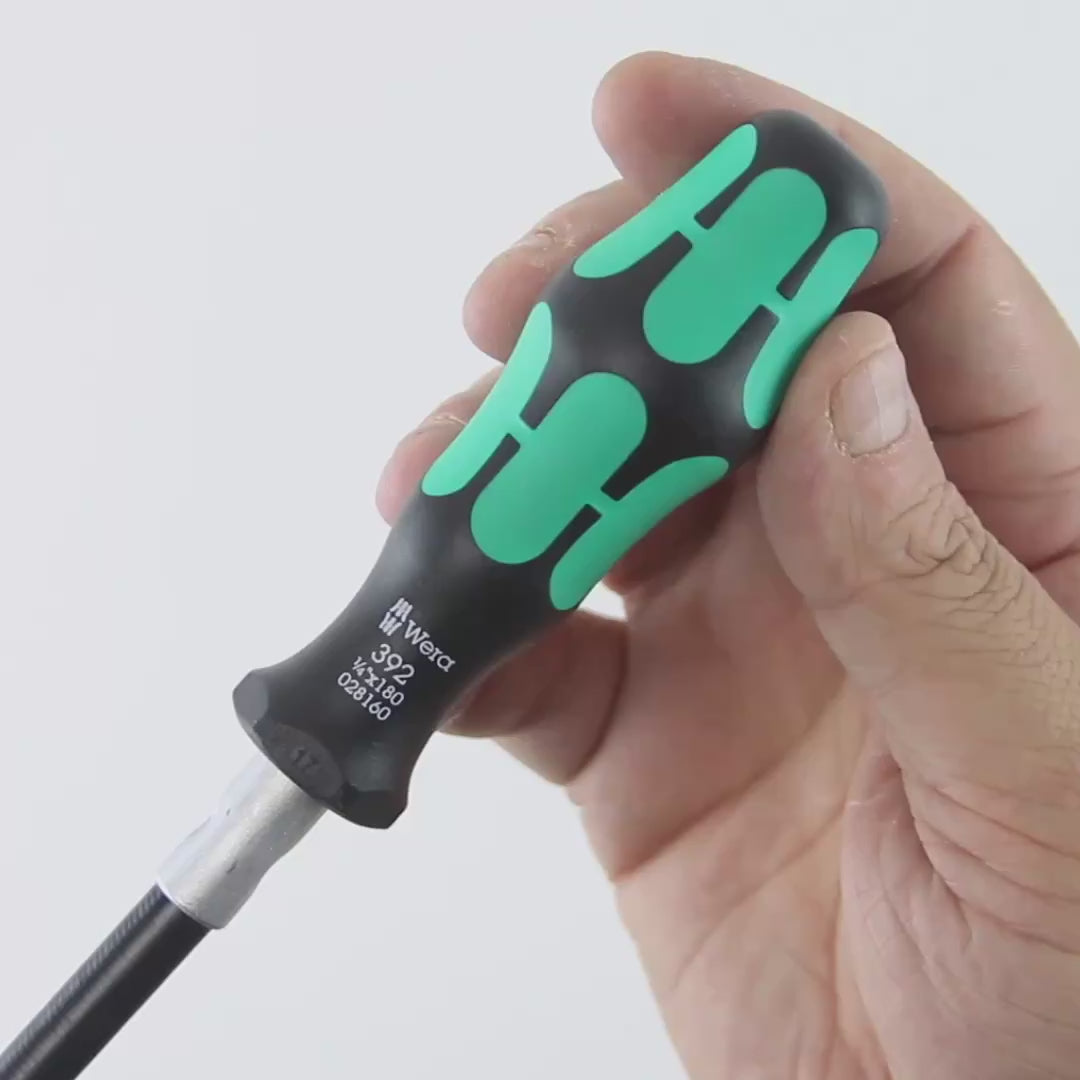

The closest would be this wera locking flex driver, with a set of nut driver bits.
Or With a locking impact adapter set.
