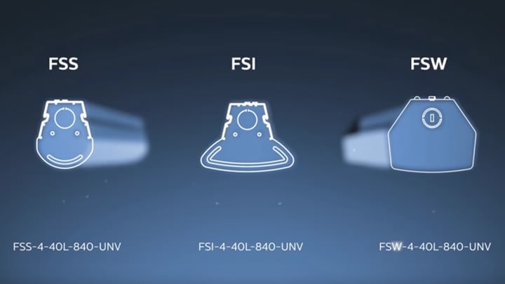

You can get LED strips, no lamps or sockets, that are 4' long, but only about 2 or 3 inches deep. Like this:
