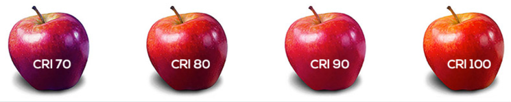

These high cri bulbs still pale (literally) in comparison to a proper incandescent.
Most of these charts are not even putting 100 CRI on them. We are supposed to just accept the inferior color reproduction of LEDs. I don't think LEDs will ever hit 100 CRI. Many "high CRI" LEDs are lying about the real CRI. There is little profit to prove otherwise.
