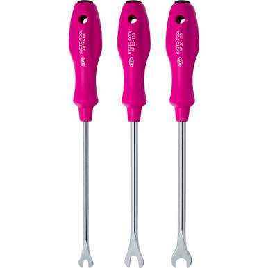

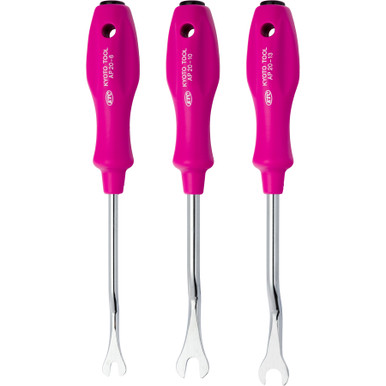

First off, some of the plastic pry bars are needed. There are just too many things that get damaged if you don’t have them.
Note that most of the time you don’t actually pry with them, but push them progressively further under whatever you want to remove, and they work like a wedge. (e.g. removing most major internal trim / badges etc).
Sometimes you do need to pry though (popping out internal light fittings or switches) at which point you find out that there are different qualities of these.IMG_0382.jpeg

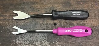

At least one trim clip tool is needed. I’ve used the Snap On for a while, and it’s not only a solid tool, but all the edges are nicely rounded and smoothed so it doesn’t cause damage.
The downside to the Snap On is that it is thick, so using it on say a door card, you need to get under there with something else first. Note that you generally get under the trim AND the clip to use these.
The KTC is a lot thinner, and I find myself using this more. In fact, I have two sizes and three lengths of these now.
The plier type tools that darkzero showed are pretty much essential for removing the clips with a central pin. I don’t think anything else enables you to get the “pin” out undamaged!
I’m liking most of the trim tools I see by KTC. Pretty much becoming my default choice now. I’ve even grown to like the colour - it’s ”real world” practical if you’re removing black fittings and black trim, and placing your tools on black seats or black carpet!
Hey, talk to me about the KTC AP203-10A. What do you like/not like about it and why it's so expensive?
My favorite screwdriver type trim tool is a toss-up between PB Swiss and Vessel. Both are cheaper than the KTC version.
https://pbtools.us/automotive-clip-clamp-detaching-wrench-set-671set.htm
I think the pink KTC wouldn't walk off or get left behind. I'm having issues moving past sticker shock. :lol: :beer:
A good question!
For some years I only owned the Snap On.
Good tool. Unlike the very cheap ones, all the edges and corners are rounded, and every surface polished and chromed, so even if you use it between a painted surface and say a door card, it doesn’t mark the trim. It’s also very strong, and I like the Snap On hard handles. Equally tough.
The downside of the Snap On is that the tip is relatively thick, and it was obvious I needed something thinner. The KTC seems to be a good compromise. Thinner than the Snap On, but still rounded / polished etc so it doesn’t cause damage. Here’s a comparison.
When you use the KTC you realise it’s been very well thought out. Even the handle material (a soft, but relatively dense plastic - very different from the soft materials chosen for cheapness) is just perfect - nice to use and cleans up but doesn’t damage plastic panels if you accidentally scrape one.
Overall, very happy with the KTC. Not much I don’t like. Cost wise, I don’t recall it being expensive. Current price for me (shipped from Japan) is about 13 British Pounds. The Snap On A177 is currently £52 - which I didn’t pay, and probably wouldn’t.
The Vessel, sourced in the U.K. is a comparable price to the KTC. Sourced from Japan it’s about half that price (£6). I’ll probably pick one up next time I order from Japan. Clip tools, like screwdrivers, are something you can’t have too many of.
For now, I’m happy with the KTC, and have picked up some others. I got a set of the AP203 so I have another of the large size. The short ones are my newest acquisition and already my most used. I also have a couple of the long ones, which I thought would be useful, but I seldom use.
It’s worth remembering that every clip tool is a compromise of some sort. You can make any tool thinner / more pointy, or thicker / more rounded, but the more pointy they are the easier it is to damage your work.
