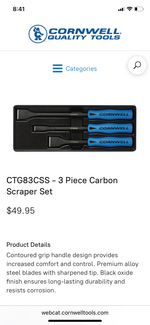

Carbide scrapers while costly, seem to be getting popular.
What do you think?
Are they Not worth it? Overrated?
Or are they really what they are hyped up to be?
Just to make sure we are on n the same page, speaking the same language…
Carbon Scrapers…
Carbide Scrapers…
