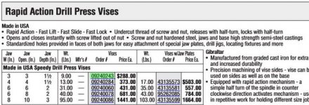

tool_scrounge
Jul 20, 2010
4,212
Southern California
Looks like Cardinal still sells them with and without jaws. Note - these prices are from MSC and you should be able to find it cheaper elsewhere.
