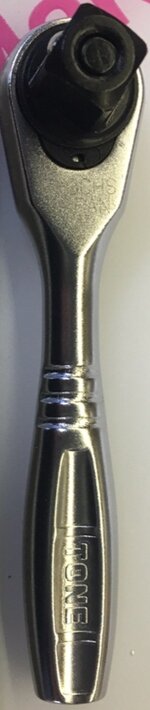

Yeah, the spring is tiny for sure! I almost lost mine when I clipped a couple coils off my TONE rebrand. They are made by Hi-Five...their Super-Ten model

Yes, made a significant difference. Did the mod 4 years ago and no regrets.
50840447852_a03aee91fc_b.jpgTONE by ChrisCas aka Superautobacs, on Flickr
Interesting, I didn't know Signet was another rebrand.
Like Fedwrench mentioned above, in North America Powerbuilt Tools is another rebrand. ... subtle differences near the handle, but the mechanism is the same:
