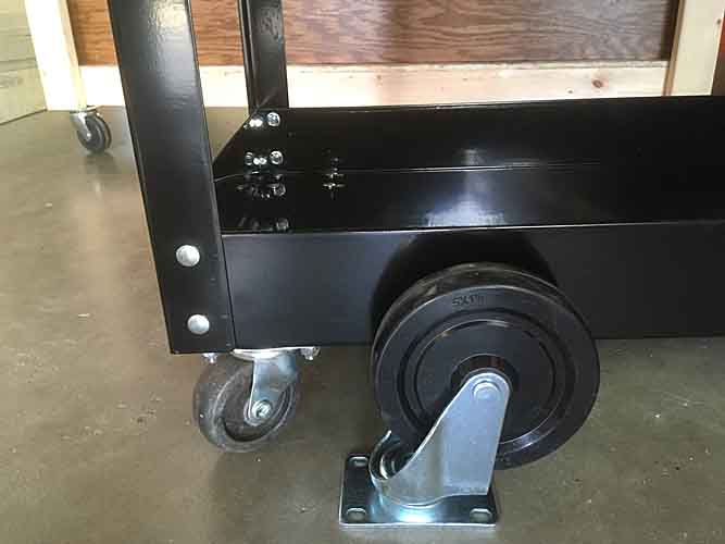

I often buy the small moving dolly and take the casters off of them
I do exactly the same. Toss in a 20% coupon and it makes the casters a real bargain.
Put them on my big rolling work table, and swapped them into HF's tech cart and moved its taller softer casters to my lumber off-cuts cart. And on some rolling shelves.
