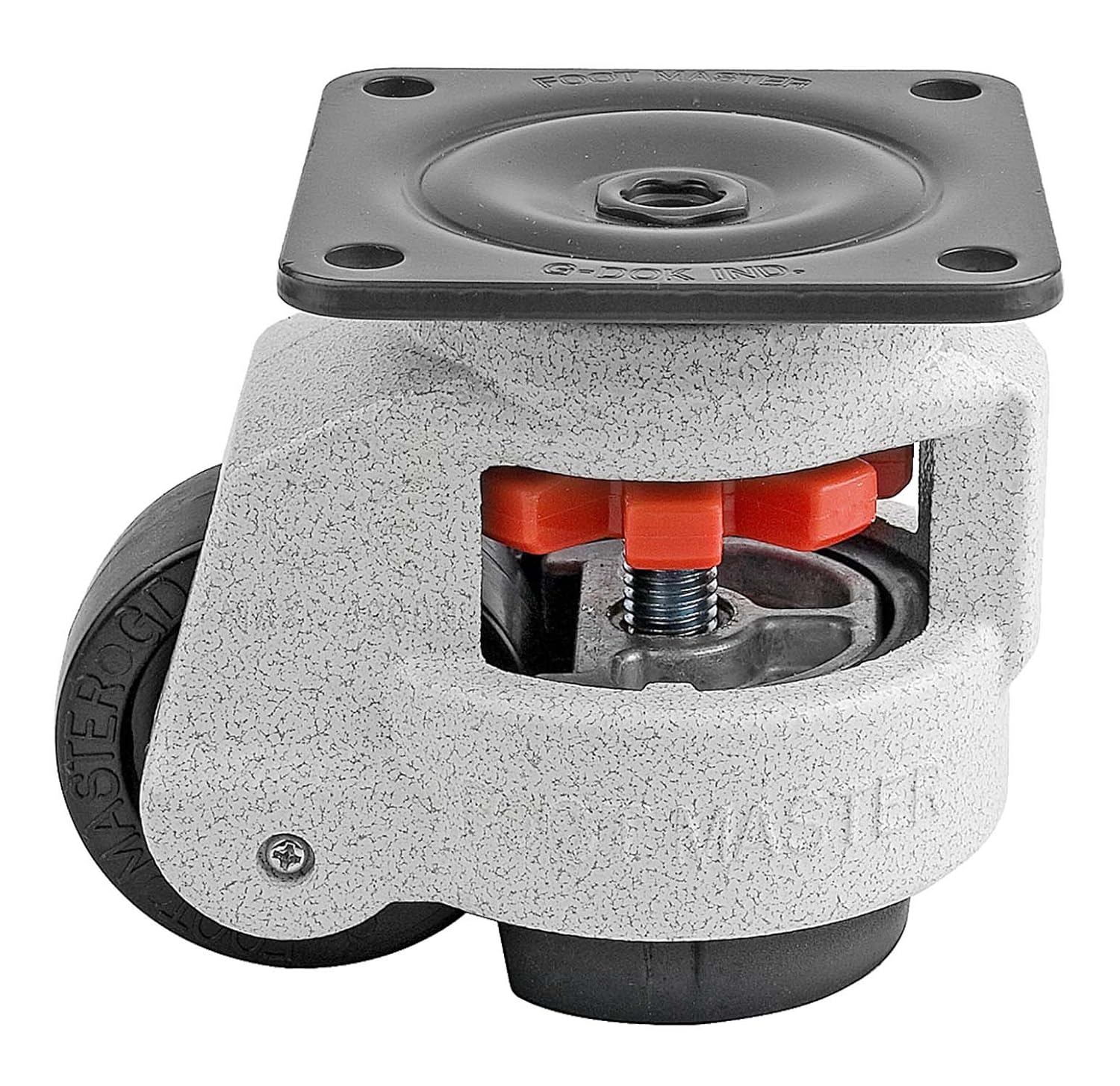

I like the ones that lock the wheel and swivel like these. Problem is don't know who made them or where they came from.
