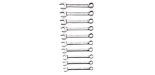

Looking for a set of high quality reversible ratcheting wrenches. This CAT set caught my eye, who makes it? Is it much better than ICON, Tekton, Craftsman V series or Blackhawk?
248-8819
AJHD
Jan 4, 2020
3,058
248-8819
Those are Williams. Rebrand as BluePoint on the Snap On truck. You can buy them on Amazon as Williams.
These are NOT made in USA, just in case that question gets asked.
248-8819
They are made in Taiwan by Cendai. The Williams Supercombos that are forged/assembled in USA use the same Taiwanese mechanism. Same for Williams Taiwan. Same for CAT. Same for Bluepoint.
These are not made by Williams as implied above, but rather sourced similarly with them all being proprietary to Snap-on Inc.
Tekton changed suppliers recently and were completely redesigned. I haven’t used them nor seen much feedback from those who have. I haven’t used the Craftsman V either. ICON are coming from quality manufacturers. I believe the Blackhawk are now discontinued, but were also good quality.
There are a lot of dependable ratcheting wrench options coming from Taiwan and they dominate the market.
My personal opinion? Find something that is easy to warranty. Ratcheting wrenches by nature have a higher failure rate than their non-ratcheting counterparts.

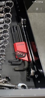

I have the SuperCombo ratcheting wrenches, not the CAT ones. Someone was referencing that the SuperCombos were not “made in America”. They are forged in America, and made in Taiwan mechanisms are installed.
I only have one CAT ratcheting wrench, and it is the BluePoint design.IMG_4980.jpeg It is laser etched Taiwan on the other side… as are the BluePoint ones.
